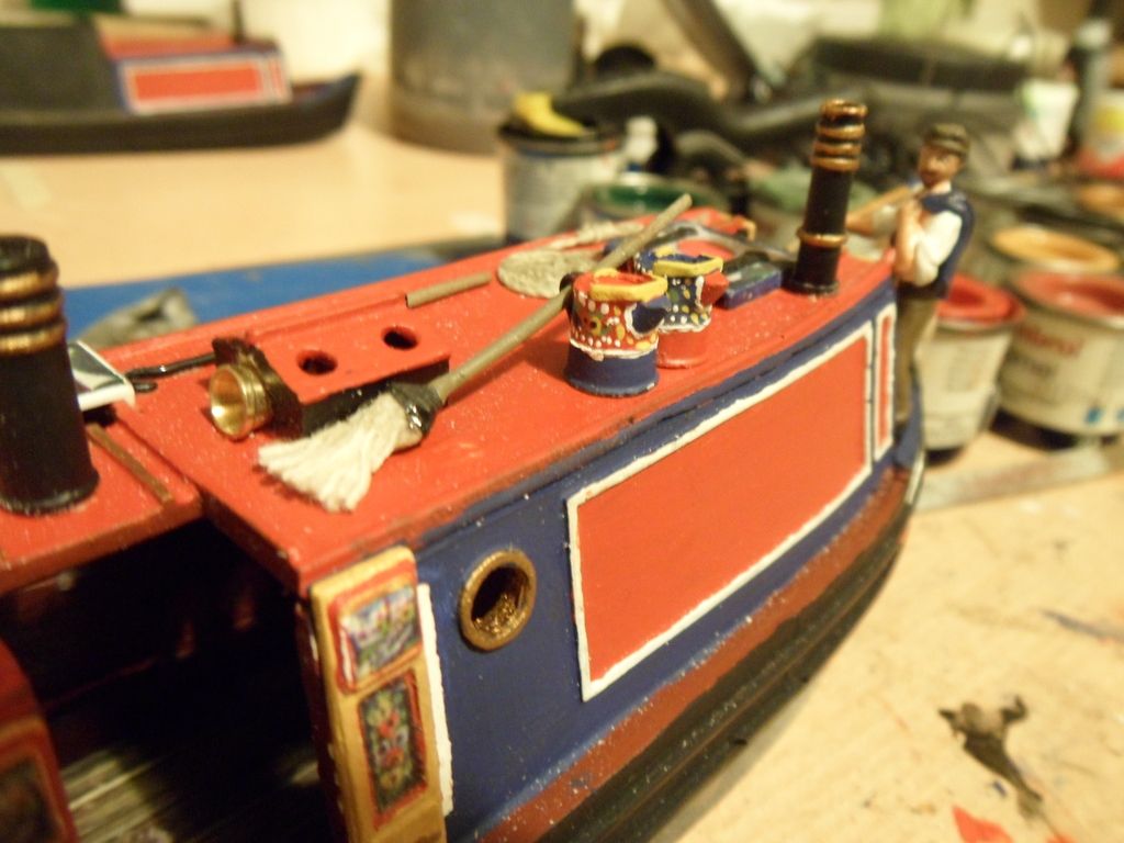

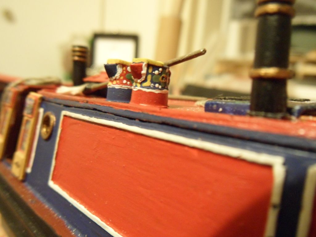

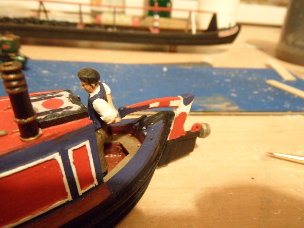

Next, the cabin roofs were painted in crimson red (typical colour for most roofs of the G.U.C.C.Co)
The roof of the motor boat is slightly different to the butty boat in that it is longer because of the engine room and it has a 'pigeon box' on top (Ventilator for the engine which also houses the horn!) The pigeon box had to be hollowed out when I removed the roof when cutting out the cabin space. the outside of this was painted black while the roof was painted in crimson red like the rest of the roof.

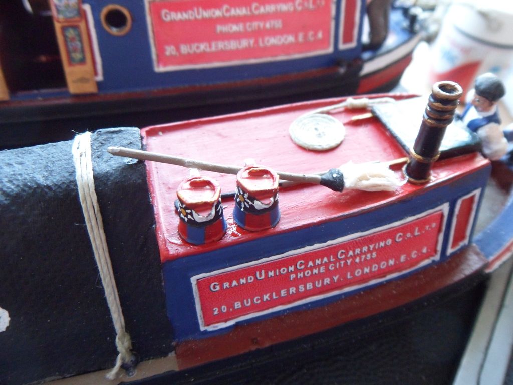

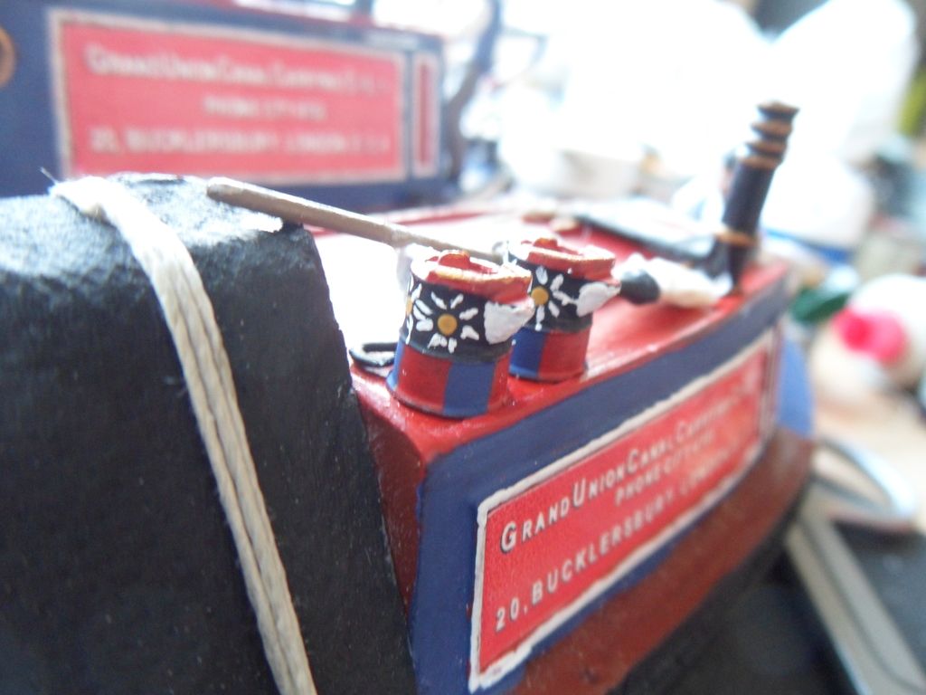

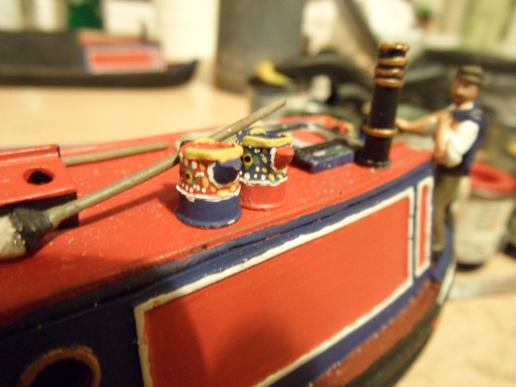

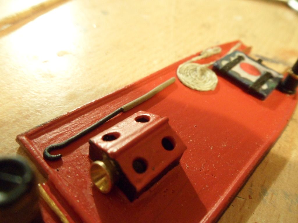

Next up, the chimneys! 8-) two on the motor boat (one for the engine exhaust and the other for the boatmans stove in the cabin) an one for the butty (just for the stove in the cabin.) painted in Satin black with brass straps, placed in position above the engine room and just to the left of the stern cabin hatch.
At this stage the horn was fitted! (it's basically a 4mm bell designed to go on model ships but shhhh! no one will know the difference! :shhh: :whistle: :lol: ) A small hole was drilled into the pigeon box and the 'horn' was glued in place.

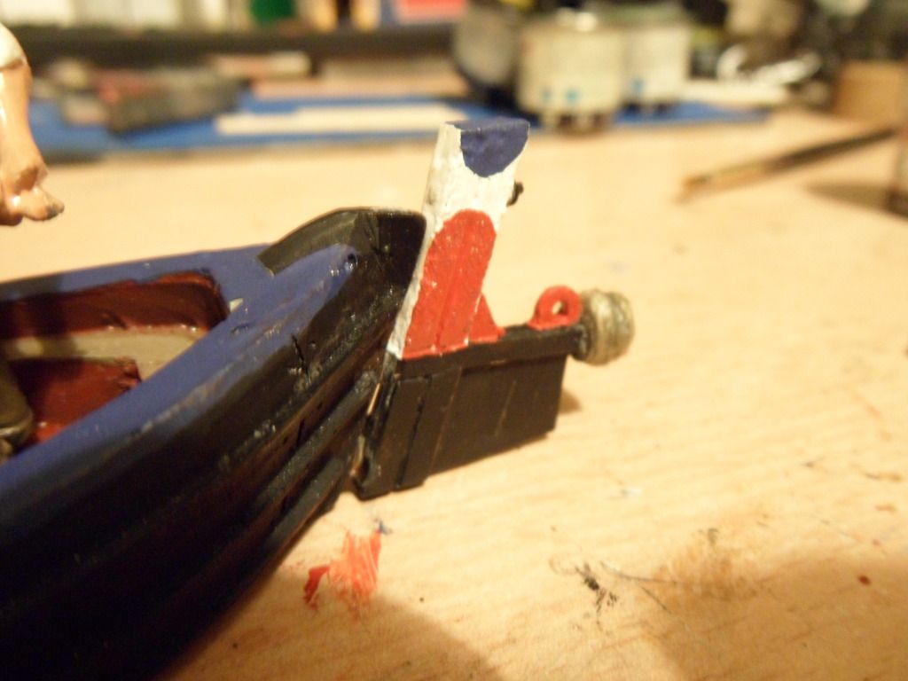

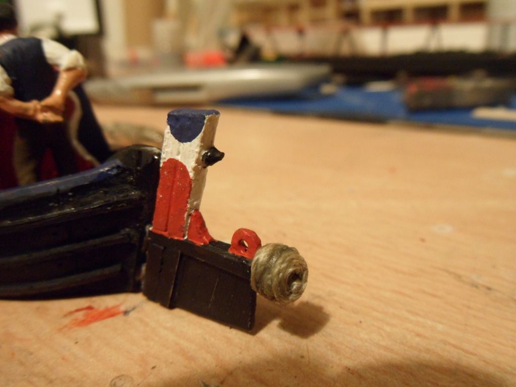

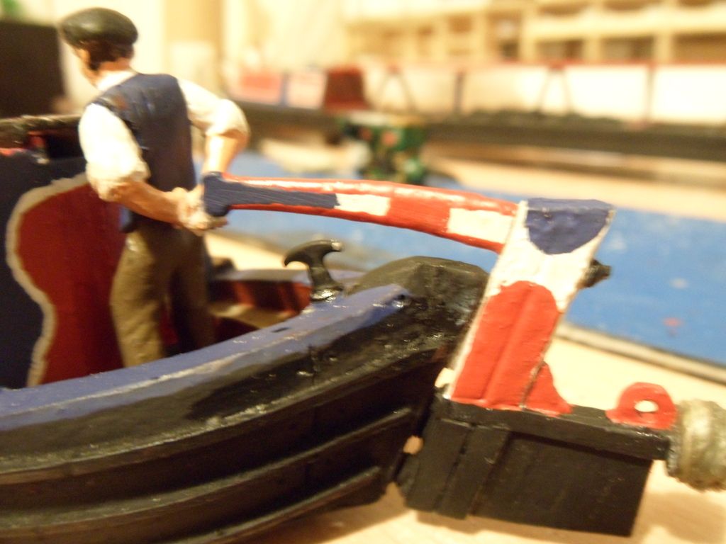

Now the stern of the motor boat needs a bit of attention. Since these boats were built in the 1930's I want to replicate their original condition! so, I need to make an adjustment to the stern plate! this was originally one whole piece of oak sat on the stern steel hull with the bollards and tiller attached to it so I need to make a packing piece out of plasticard.
After this was glued in place, the stern piece(s) were painted in Insignia blue (also characteristic of G.U.C.C.Co).

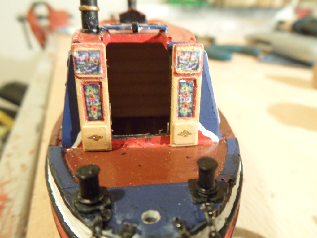

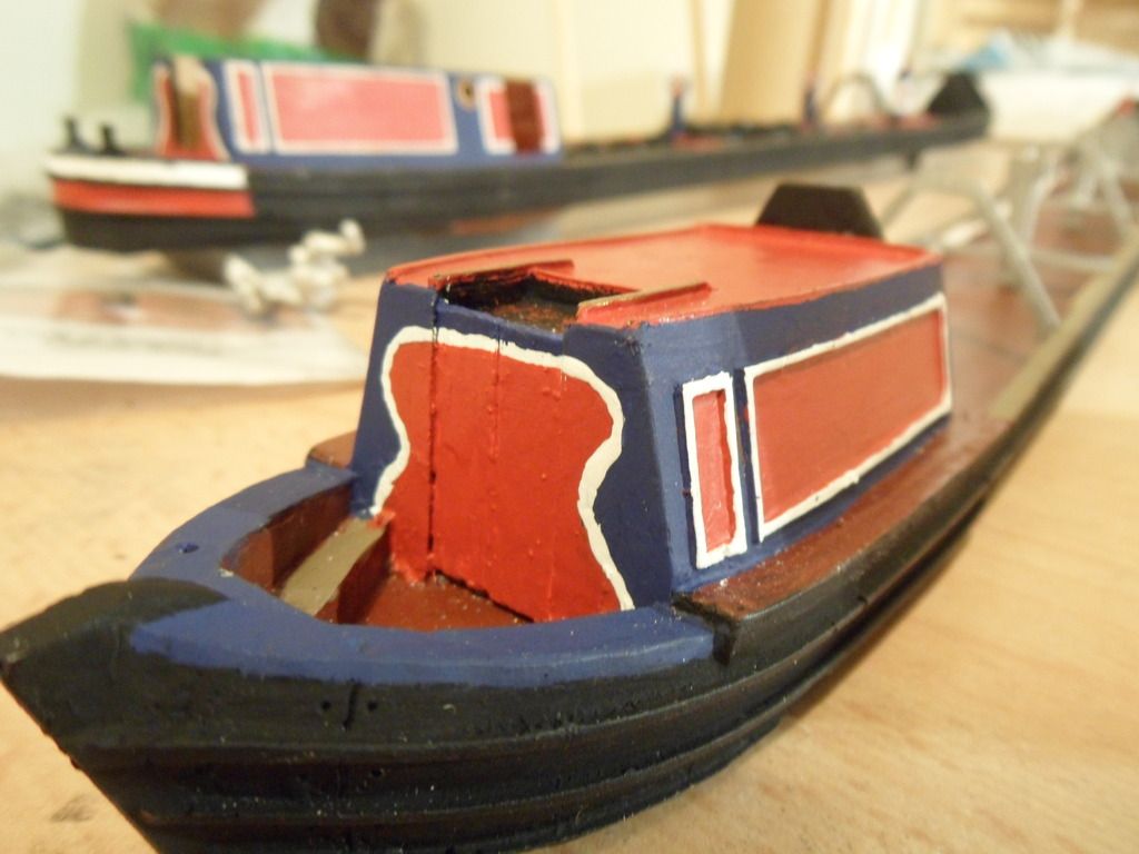

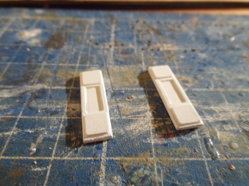

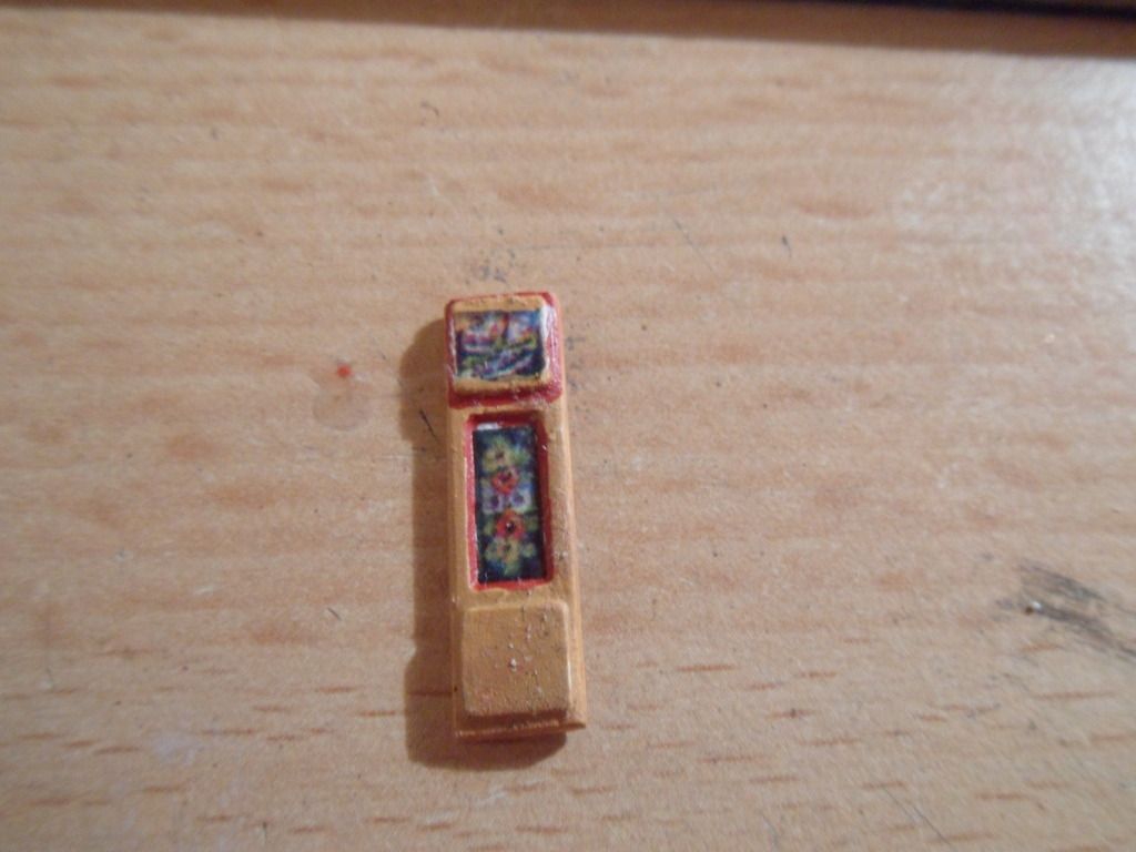

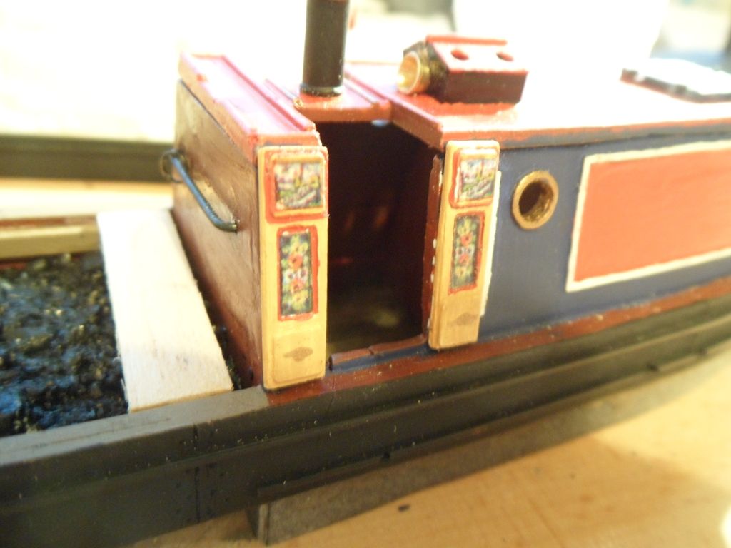

Now for the cabin paintwork! :dance: (on these models I'm going to leave the cabin doors shut on the butty boat but open on the motor.) The paintwork is the same for both boats so the photos may alternate between them! :shifty:
The stern decoration on canal narrowboats varied considerably! it varied between painters and varied between canal carrying companies! in fact, a well trained eye could tell which painter painted a particular boat, and which company fleet the boat belonged to from a distance purely by the pattern on the stern cabin doors. They varied between quite elaborate artwork to simple designs. I've chosen a really simple design for my boats (mainly because the G.U.C.C.Co tended to favour the simple designs and because I cant be bothered to do very intricate painting! :o :snooty: Yet! :shifty: :snooty: :laughing-rolling: ) Anyway, the back cabin! :lol:
I firstly drew on the pattern,
then I painted it accordingly! Insignia blue on the top and crimson red underneath! This colour scheme carries on onto the cabin sides with blue on the outside and red on the inside of the panels.
Caw! that was an awful photo! :o :doh: Some of you eagle-eyed people may have spotted the white border around the engine room doors! well this white border also seperates the other panels too, on the cabin panels this is easily painted as the relief has been pre-moulded onto the model! but for the engine room panel guess what :?: I have to do it myself! :evil: Ah well! this is how I've done it!
First I drew on where the white line would go,
Then painted roughly over the line,
I then got some 1mm fine masking tape, placed it over the white paint and painted the other colours over the top! (at this stage I also painted the brass porthole frame as you may notice! or not! :lol: )
And voila! :D (I also used this method to do the stern cabin doors!)
The motor boat cabin roof also received the same treatment with a dash of blue making sure the handrail beams stayed red!

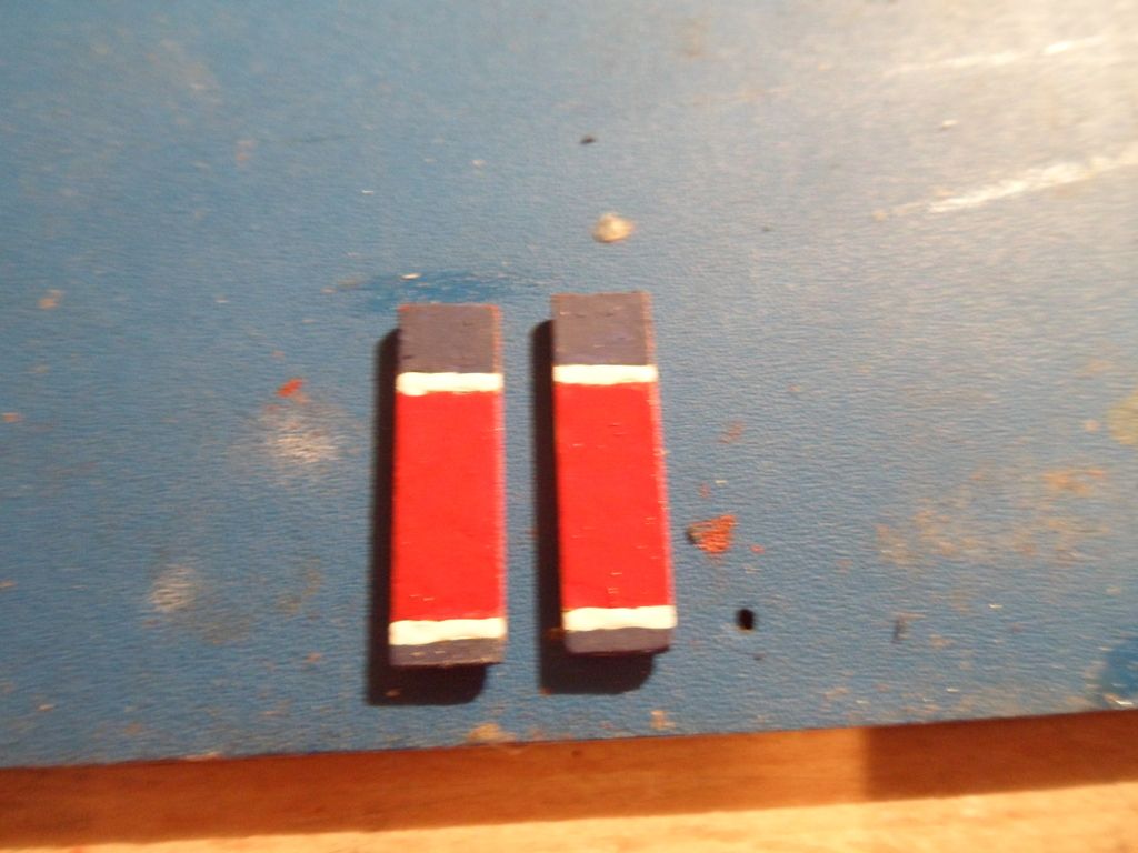

And finally for this edition of the build diary, the characteristic red and white stripes of canal narrowboat sterns! very simply white on the top, red on the bottom, black above the waterline and on the rubbing strakes. (this was tidied up after I took the photo! I assure you! :? :shifty: )

But first, a photo which I missed out from the last post, the red and white stripes of the stern counter section are also featured on the bow.

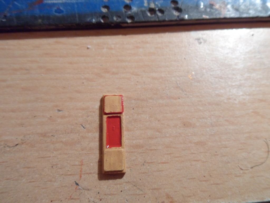

So then, the cargo hold! first I need to build the rails that will hold the planks supporting the pillars that will hold up the duck boards.
This is made up from some unused strakes from the HMS Hood model, painted light wood brown and glued in place.
Next I need to modify the supplied pillars to make them look more authentic and to give them my own personal touch! I started with the original castings, (the first one is a little different from the other 2 so I'll cover that separately!) and cut the 'wings' off.
I marked on where the planks will go (level with the rails running down the hold) and made the plank (which is basically left over Bismarck planking with a slot cut into it.) and glued it on making sure it was level and in line with the rails.
And tested it in position. (eagle eyed viewers would have spotted the locating holes in the hull earlier! ;) )
Now for the special first pillar (The mast!) this is chunkier than the other pillars and has the mast attachment on the top to which a 140 foot rope what attached which the horse in the old days used to tow the boat.
So again, I took the casting and cut off the 'wings',
After filing off the burrs, I filed the corners to make decorative edges and then set to work on the plank which is a little different to the others.
These planks are wider than the others and are open one end! this is so te mast can be maintained and/or replaced at any time.
because it is wider than the others, I have to make the plank out of two off-cuts of planking. Glued together and marked with the pattern, this was then cut out and hey presto! :D
After gluing to the mast, here's the finished article!

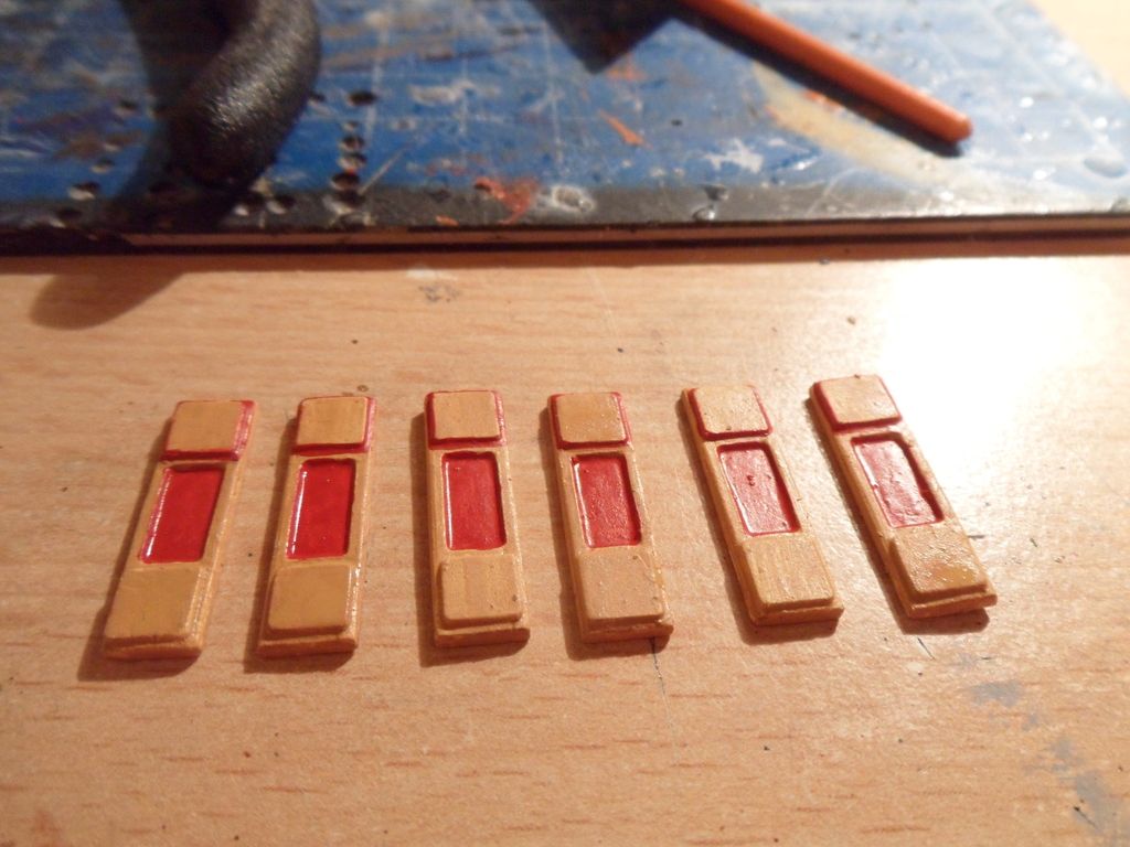

Next up are the support ribs for the canvas, these needed very little modification (just re-shaping and adjusting the angle.), just painted black! I had to make a couple of extras as the kit only supplied 3 per boat but I wanted 5 per boat just to make it easier for me! :o :snooty:

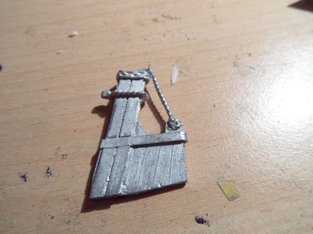

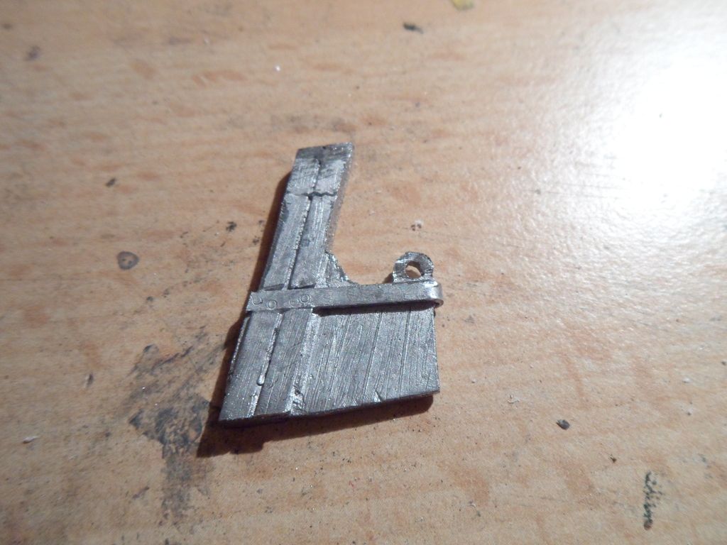

Now for the head and tail boards, I used the head board from the kit but modified it slightly (what a surprise! :mrgreen: 8-) )
Starting with the original casting I cut off the rather sad looking head light mock-up and filed it down.
Painting it black, I glued it in again having to adjust the angle! (testament to the useless castings!)
The tail board (for the butty only) was a little easier! just a shaped off-cut of 5mm plasticard. after painting black was glued on to the front of the cabin.
here's a couple of shots of all the bits tested in position to show the arrangement. (the duck boards in the first photo are the kit castings but are only there for demonstration! they will be thrown away and replacements made!)
I've also made support beams for the head boards (and tail board for the butty) to help when I come to do the canvasing.
Once I was happy with the arrangement I then painted the pillars and masts in the red, white and blue of the livery with below the hold planks in Bauxite red and the planks in crimson red.

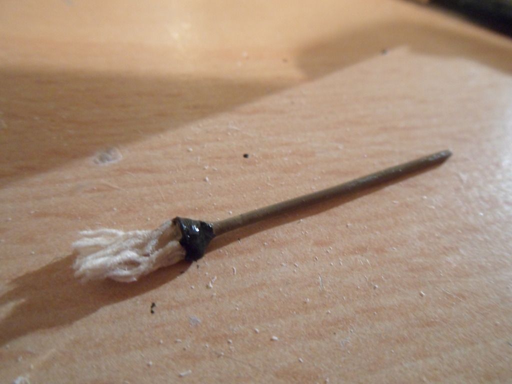

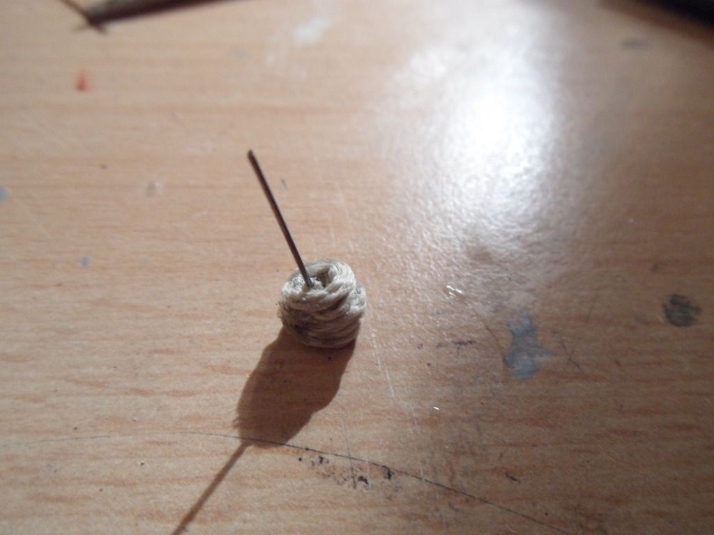

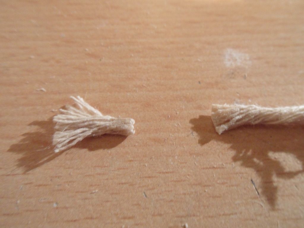

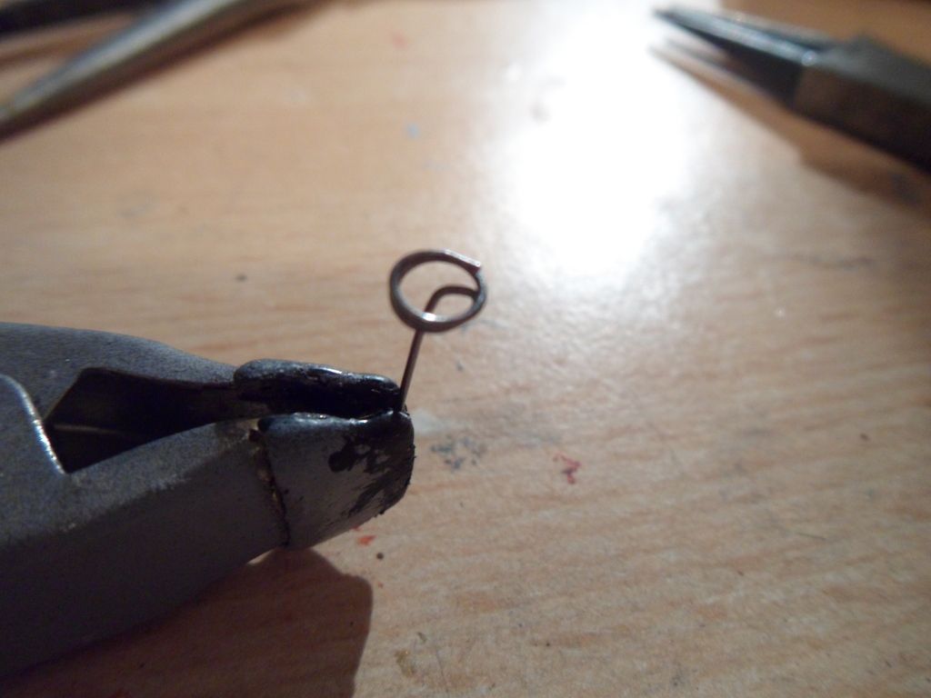

Finally, before starting the canvas I'll attach the 'horse' traveler to the front of the engine room on the motor boat (the butty would have had one too but I'll be covering that up with the canvas). This is simply 1mm wire painted black and glued on! But first I need to make the holes.
But before I attach the traveler I need to make the steel ring to which the center line will be attached. (simply a brass ring used for rigging painted black.)
Photos showing the traveler glued in followed by the ring.

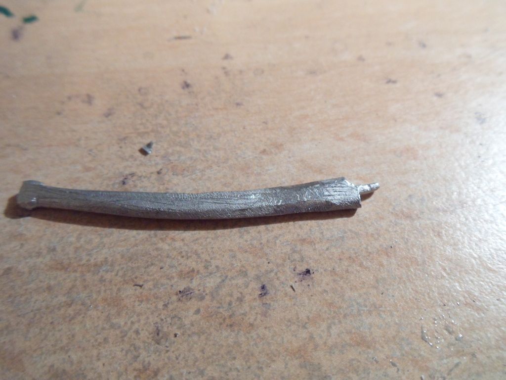

Postby tom1992 » Sun May 10, 2015 10:11 am
Ok everybody, time for the canvas.
As mentioned last time, I'm going to sheet up the motor boat slightly differently to the butty. On the butty I'm going to stretch out the full canvas over the entire length of the cargo hold but on the motor I'm going to do full canvas over half the hold and just the lower canvas sheets for the rest of the hold leaving a small section open and rolled back to allow access to the center line.
But first, the duck boards need to be installed and we need some cargo! :mrgreen:
So, the duck boards! again, these were made from sections of spare Bismarck planking, cut into lengths fitting the spacing between the pillars with scarf joints cut into them.
After being painted crimson red like the others these were glued on to the butty but left off the motor until I have 'loaded' the cargo 8-)
Ok, now for the cargo! These boats would have carried anything from milk to grain and oil and everything in between! I've gone for the fairly traditional coal load. There are many ways that you can mimic and give the impression of miniature coal and all of these ways have pro's and con's for them, but for me, nothing can look as good as the real thing! so I'm going to load real coal into my boats because it looks the most.... um.... 'realistic'! :shock: :laughing-rolling:
I've got a little pot of mixed sized mini coal chunks which I've made by wrapping large(er) coal chunks in an old rag and smashing them with a mallet! :D a man of precision me! :laughing-rolling: No half measures! :lol:
I just tipped the coal into the hold about two thirds the way along making sure that the coal is mounded up nearer the middle of the hold and below the gunnels at the stern end to give the impression that some coal has already been delivered and the boats are on their way to the next delivery.
After I was happy with the arrangement, I glued the coal in place using a slightly diluted PVA/water mix with a drop of washing up liquid to break the tension, applied with a pipette.

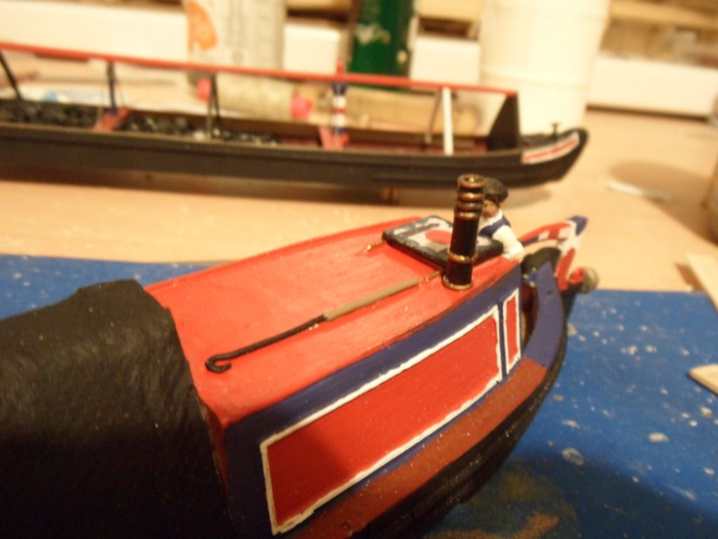

Now that I've got the coal stuck in I can make the center line on the motor boat without it being covered in coal. I've made this with .8 mm twine.
First I've tied it to the ring,
Then, using a pair of needle nosed pliers I've wound the twine round the prongs (leaving a bit of slack) and then glued it with super glue on the top and bottom (taking care not to glue it to the pliers) :superlglue: which has left it in a nice neat coil.
I've then cut off a section of the roof I separated and painted earlier and glued it to the cabin and then glued the coil onto the top. (once the duck boards were in place!)
(photo appears later)

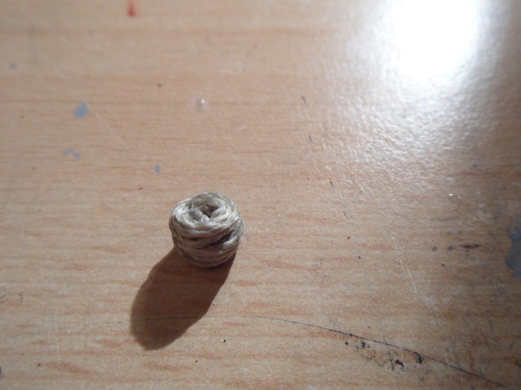

First, I made a small coil on a sheet of plastic by putting a spot of superglue down and winding the thread round it,
Then I looped the other end through the first eyelet, (Ok, It's a different photo of a different stage but I'ts the same principle! :roll: )
I passed the thread through the other eyelet over the top of the canvas and repeated it twice before gluing the coil to the left side, making another coil and gluing that to the right side. And... after all that, I'm left with this! :dance:
And after doing it twice more and a fourth one at an angle across the head board, it looks like this. :D 8-)

Hello again! :D In this section I will be focusing on bits and bobs, fixtures/fittings and this and that! Some of these things you will have seen in some of the other photos as I've installed them at different stages but i thought I'd talk about them all in one place for neatness sake and simplicity! ;) :lol:
So first up (and in no particular order), The large rudder or 'Ellum' on the stern of the butty boat (including the tiller).
Again, starting with the original casting, I've removed all the horrible flashing and moulded details and tidied it up a little, The tiller received a similar treatment!
Next, the Ellum received a nice new coat of paint in colours funnily enough look very similar to the rest of the boat!! :think: :laughing-rolling: The little black knob on the other side of the Ellum stock is a blob of superglue gel painted black which will become the dirty great bolt that holds the tiller on. After painting the Ellum was then glued onto the butty sternpost.

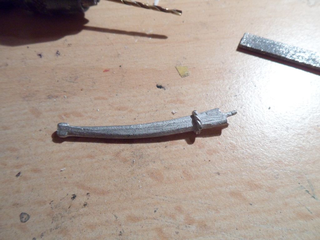

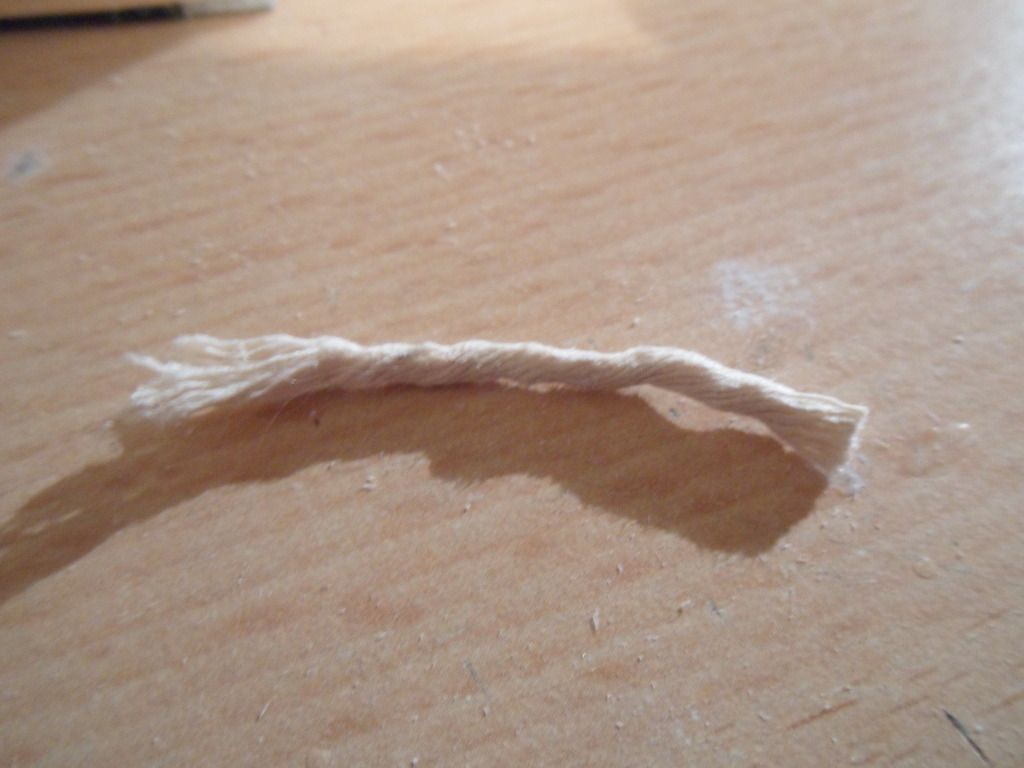

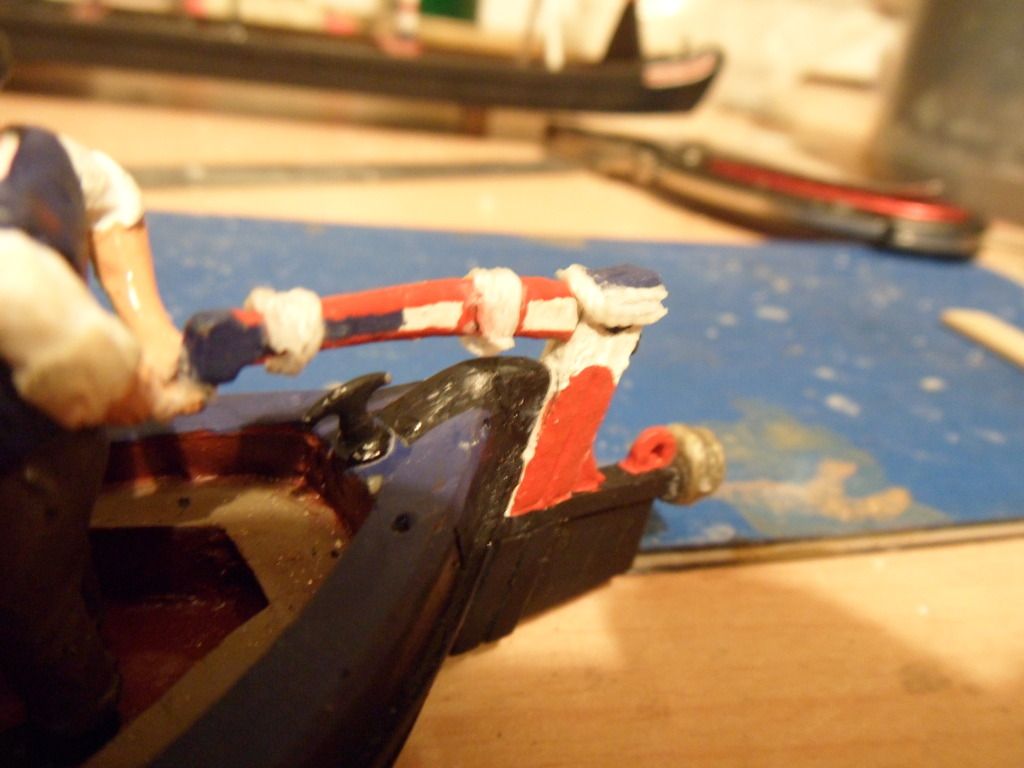

The little rope button fender that you can see on the end was made from a length of .5mm steel piano wire bent into a shape like thus,
I then got that good old .8mm twine that is becoming famous in this build diary so far :lol: and wrapped it round until it looked something like this, (it kinda looks like a funny coliored candyfloss!! :lol: )
After removing the shaft, it looks like this! It was ten glued to the end of the Ellum and Voila! :D
Next up, the tiller also had a paint job again same colours but in a different pattern and glued to the Ellum stock (making sure it's in line with the black blob/'bolt') The tiller arm had to be shortened as it was far too long! the boatmen would have been able to hang their washing off it inside the cabin! :lol: After shortening, it now fits into the hands of my little butty steerer (covered later in this section).
I then added the decorative ropework using the same braided white thread as used earlier. And that completes the Ellum! :dance: The motor boats rudder is considerably smaller and won't be seen above water except the little loop on the end but that'll be added later.

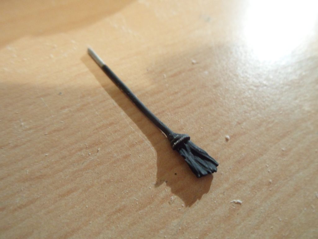

And now for something completely different..... A mop!! :laughing-rolling: :laughing-rolling: No really!.... A mop! ;) one of two mops that would have been stored on the cabin roofs. The castings looked horrible so I had to replace the mop head for my own version! see what you think...

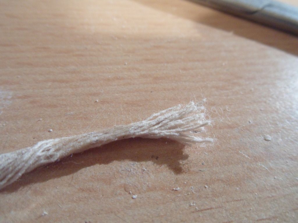

First, the casting Yuck! :puke-front: So I removed the mop head at the base,
I then got some string, unraveled it a little bit and placed a blob of glue in the center.
I then cut a bit off at the glue mark and after tidying it up a bit, I glued it to the suitably painted shaft. Voila!! :D The other one was made in exactly the same way and they will be attached to the cabin roof later.
Okey dokey. and now for some water cans! (Called Buckby cans) :) (no joke this time ;) ) I haven't modified these in any way as there was no need to. All they needed was a nice paint job! These were often painted very elaborately but I cant be bothered so I did a simpler design! I decided to paint the ones on the Butty differently as each boat had uniquely painted canalware. They were then glued to the roof and the mop handle was inserted through the handles of the Buckby cans.
Pretty cool eh? :D
Also featured on the roof of the cabins was a boat hook. used for pulling out weeds etc unhooking lines and closing lock gates (and any other use a boatman could find for it! ;) ). Same as the Buckby cans, all they needed was a coat of paint and sticking down. :handgestures-thumbup:
Hmmm... what next?? :think: I know... the doors! :banana-dance:
Again, no need to alter the castings bar a clean up, they just need a paint job and a bit of colour adding,
So starting with a yellow ocher surround, then crimson red was added round the raised bits and in the recessed bits,
Most of the doors will be glued with their backs up against the cabin sides so there is no need to paint the other side, but two sets of doors will be in the closed position, (the rear butty cabin doors and the starboard engine room doors on the motor boat) So they need to be painted to match the design on the cabin sides in those locations,
After the doors were painted in the base colours, they needed the final details adding! Usually, the doors were painted with elaborate paintings of roses and castles which some of you may have heard of! this is rather difficult to paint in such a small scale so I've chosen to 'cheat' and buy a decal transfer sheet for canal boats!
Half of these transfers i wont use as I'll be doing it myself (ant they look pretty terrible anyway!) but in this stage I will be using the transfers for the doors, so I cut them out!,
As I've already painted the doors in a better (more realistic colour), there is no need for the whole transfer! so I cut out just the roses and castles bits and placed them in water as is the usual way and applied them to the doors! :D
Finally, the doors need to be glued in their various locations and we're done! :dance:
