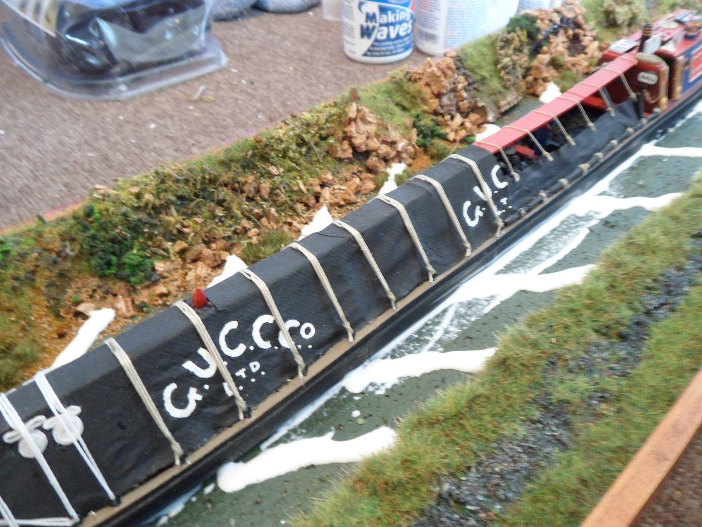

Postby tom1992 » Tue May 02, 2017 9:33 pm
Hi everyone!

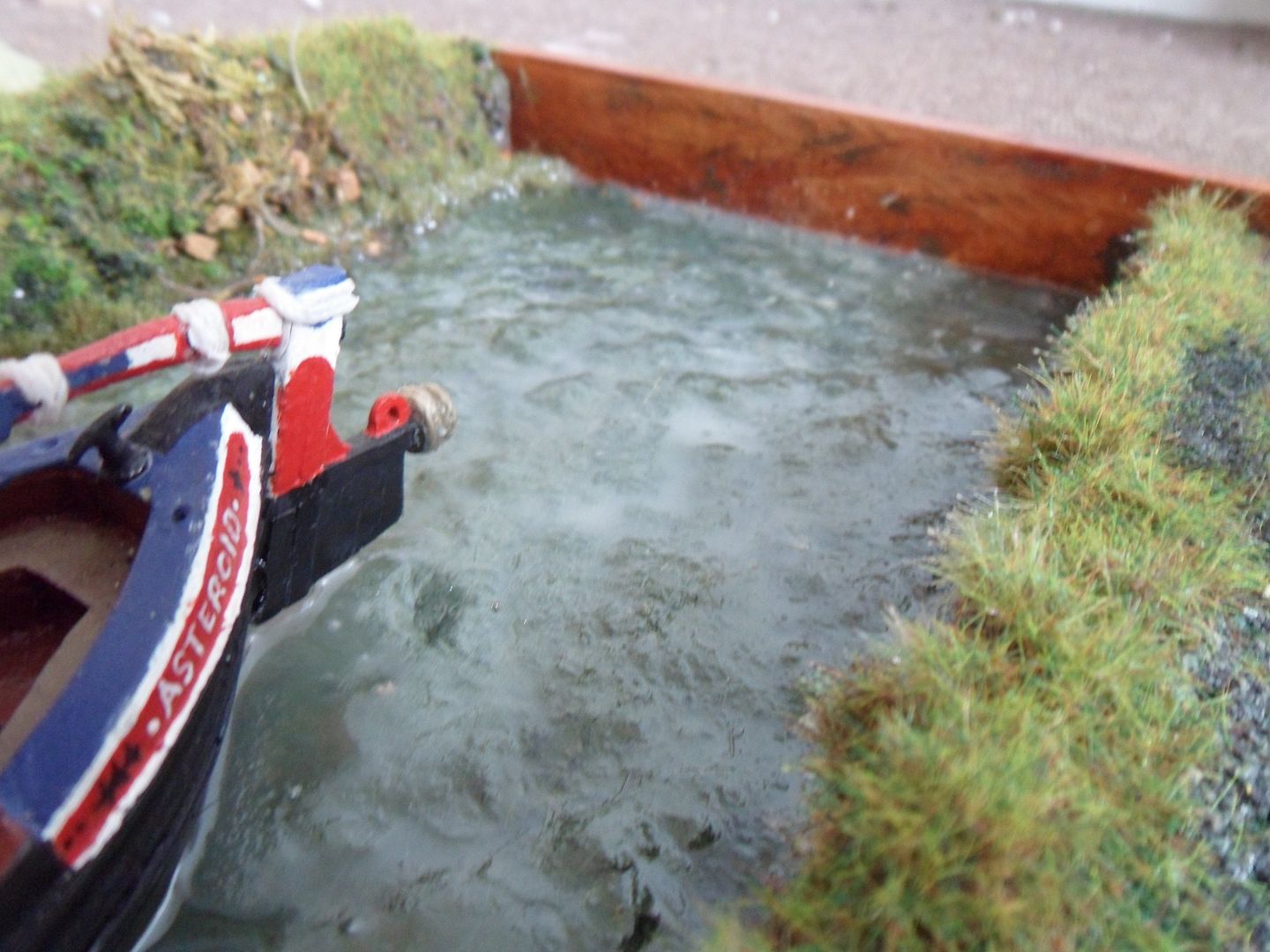

It's tome to get wet! :D A few people have asked me (on here as well as those who have seen the model in the flesh) how I've got the water to look so realistic! So, I'll try my best to explain exactly what I did! However! If you've got a question on a specific bit that I've forgotten to mention, or would like a bit more info on please post a comment below! :)
So, the first job was to glue the boats in! nothing special here, just needed to position the boats centrally, not too close to the opposite bank (which would have been shallower that the towpath side!) and level so that the 'Ellum' on the back of the butty sat nicely on the polystyrene and position the two boats close enough that the cross-straps joined on the bow of the butty,

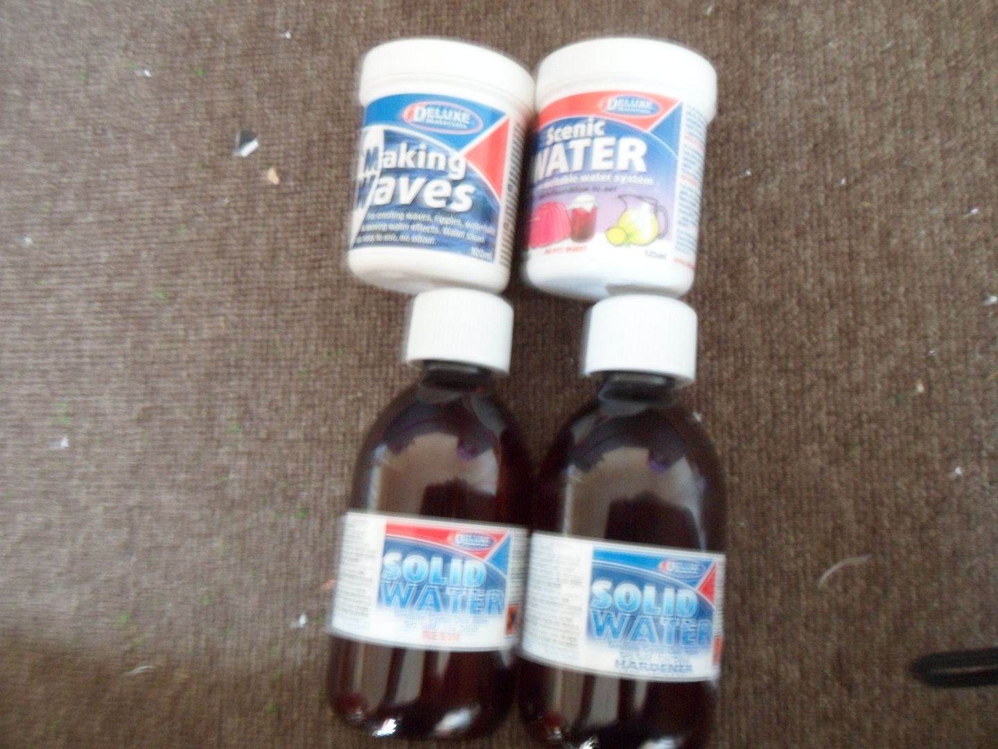

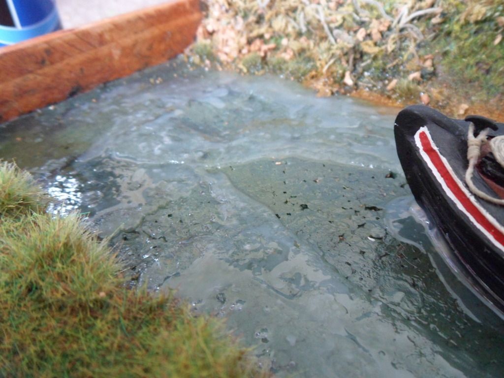

Now, to make the water I used 3 different types of model water effects! I'll explain why I've used each in turn as we go along but here are the different types, Top left is 'Making waves' this is basically PVA mixed with a resin that holds its shape (kind of like well mixed meringue!) I'll be using this for waves etc. top right is 'scenic water' This is normally used for making small liquid items such as jelly and drinks cups for large scale dolls houses etc. It's like a resin that you have to melt before you pour! (I'll explain how and why I've used this later!) and the bottom two bottles is a 2-part resin called 'solid water' (all these products are by Deluxe BTW.)

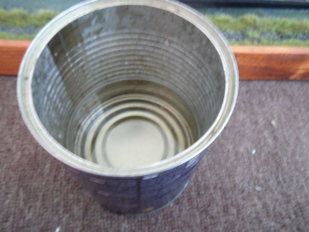

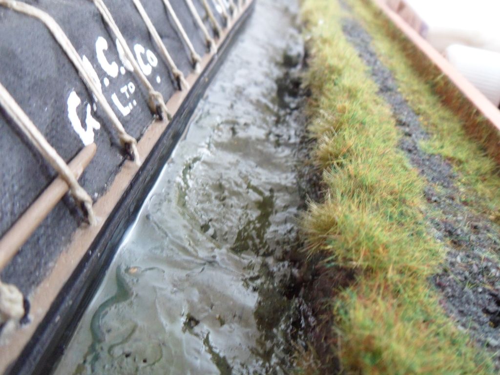

Ok then, the processes! Now, when a canal boat travels through the water, it stirs up the mud at the bottom creating mushrooming clouds of silt that come to the surface. This is what I hope to replicate! So, using the 'scenic water' (which has to be melted) I heated it until the jelly (which is what it looks like straight from the pot) has melted! I kept it in the pot to make it easier to pour and melted it by sticking it in a pan of hot water until melted. Once it has been melted I left it to cool for a while! Polystyrene being expanded plastic will melt very easily by something hot (as anyone with SWMBO drying her hair nearby will know! :laughing-rolling: :laughing-rolling: ) so, once the solution has cooled a bit (explanation soon!) I poured it over the second half of the canal base. This allowed the polystyrene to melt just enough to create dips and bubbles in the surface which looked like mushrooming mud (without just destroying the polystyrene which would have happened if the solution was piping hot!) also as the polystyrene bubbled away, some of the whiter bits of the polystyrene showed through mimicking areas of clearer waters. ??Confused?? :? :shock: Pictures speak a thousand words so see below!

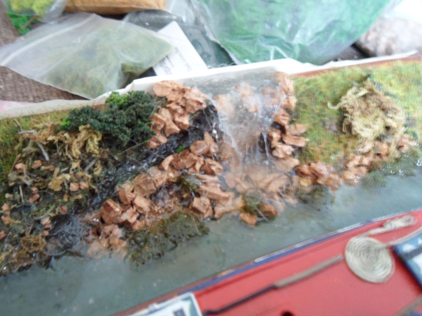

So that completes the first stage! the second stage is to use the 2-part resin to completely cover the canal base by about 3mm (the depth has already been emphasized by the painting and the previous stage!) I did this in 2 stages, the first to cover the bottom then once it was level and dry, used a second batch to build up the layer to the desired height (about 3-4mm below the level of the gunnels on the boats), Once dry, thus completes the second stage!
(N.b The polystyrene being porous tends to suck up the resin until it becomes saturated and the resin fills the gaps! thankfully I had enough resin and this wasn't a problem but it did catch me off guard a bit! see second photo!)
the scene after the first batch of resin!

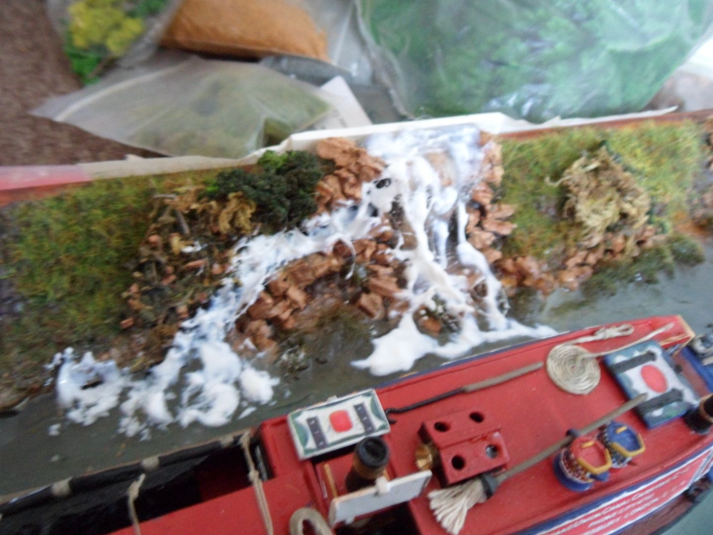

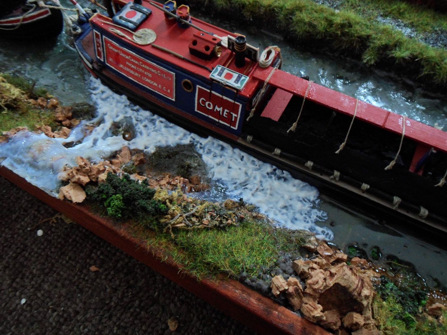

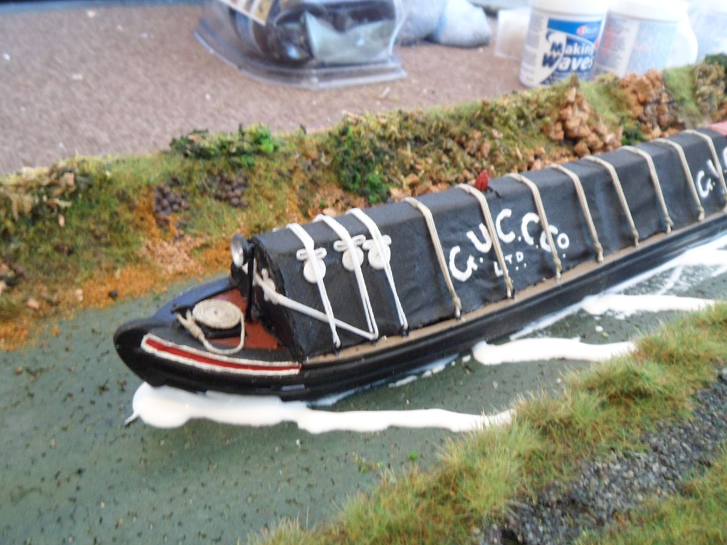

The last stage before we get to the waterfall is to make waves! (using 'making waves' which is an interesting coincidence! ;) :lol: ) As I said before, this is basically PVA (so it dries clear) with an additive that allows it to hold it's shape making it perfect for making ripples, waves, splashes etc. etc.
So, I started by painting it over the model in streams simulating the bow wave as it travels down the length of the boats (creating a big bulge at the bow of both boats)
Then, once this was dry I pasted a medium thickness layer over the entire canal bed and allowed it to go slightly tacky, I then took a small sponge and dabbed it to make tiny peaks to simulate disturbed water, As the solution continued to dry, these leveled out slightly to make a convincing ripply effect! after this was dry, I used the solution to build up layers against the sides of the boats and especially around the stern of the motor boat to simulate the churning water created by the propeller! and behind the Butty for the wake. (sorry I have no photos of this but here's a finished photo to show what it looked like!)
The stippling effect
The prop wash effect
The wake
The bow wave
And that completes the canal part!

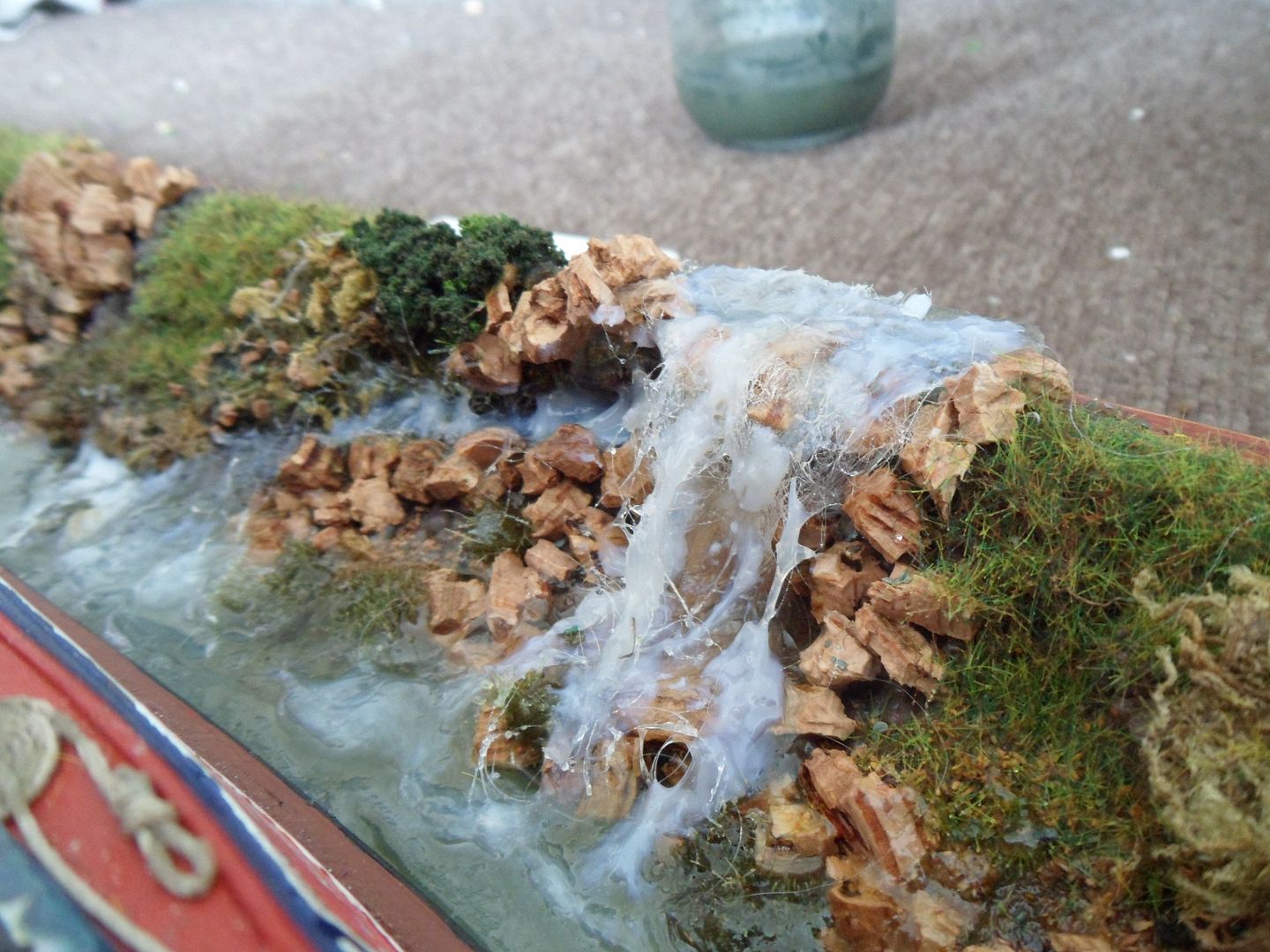

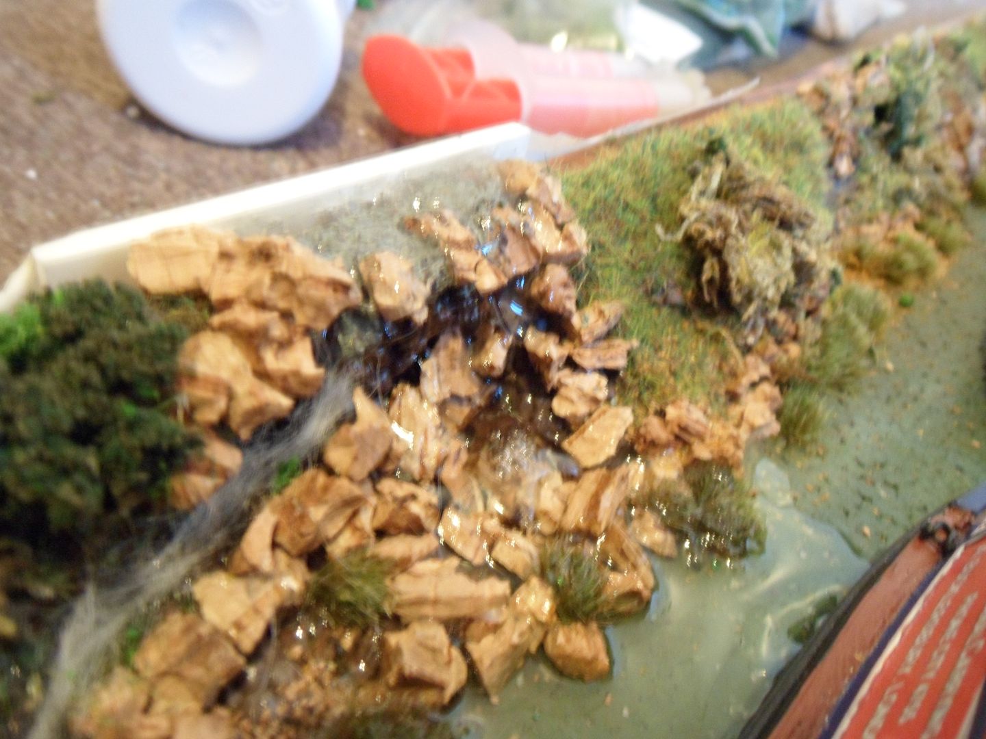

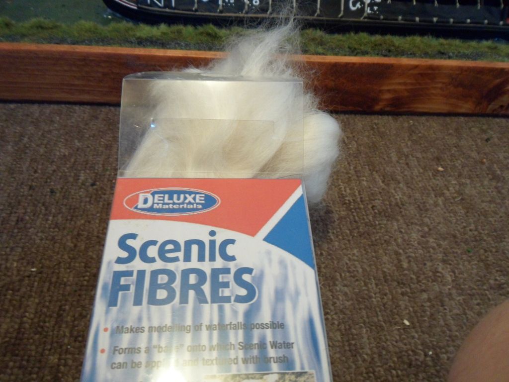

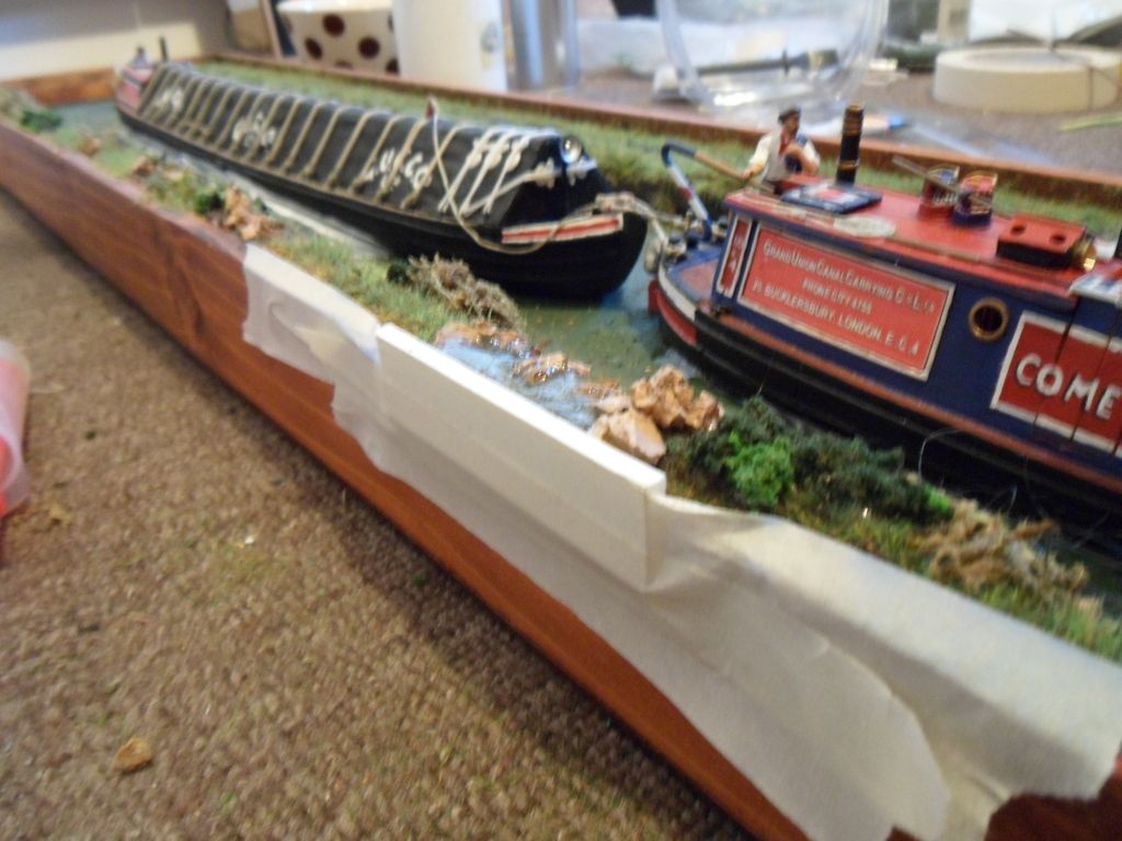

Finally, here's how I made the waterfall.
To start with, the main drop and the diverging path were treated to a coating of gloss varnish (the all purpose D.I.Y shop stuff) to stop the resin seeping through this time! (an old photo of a previous stage but relevant!)
I then got a box of scenic fibers (also from Deluxe, cotton wool teased out would have done the same job but I bought these as they are relatively straight and so I could direct them where I wanted them!)
To make placing the fibers easier, I took a bit and sprayed it with SWMBO's hairspray to make it slightly tacky (she gave me a bit of evils at the time! :laughing-rolling: :laughing-rolling: :evil: ) and then using a cocktail stick, pressed it into the diverging path and main fall giving it a realistic direction down the slope and round the boulders,
Then, using a strip of plastic and masking tape, I sealed up the top of the waterfall and got the resin mix out again!
Pouring it in from the top to simulate natural water flow, take a cocktail stick to pull the resin in and around the rocks and boulders (the same technique was used earlier for the main canal but I forgot to mention it!) to make sure the resin covers all ares! making sure that the resin flows down the fibers to simulate trickling water. (a couple of layers may be necessary, I used two!)
After the resin has dried, It's time to get the 'making waves' out again, this time dabbing it along the waterways and down the fiber strands in layers to beef up the cascades! also over the canal bed to make churning water (taking note of how the water will 'bounce back' off the boat), building it up in layers is the key here! Also adding a few streaks of white paint simulates 'white water'.
After several layers, this is the result! Once it was dry I trimmed the excess fibers off and tidied up some of the reeds and bushes that had resin splashed on them.
And there you have it! a canal scene complete with cascading water feature! looks just the part! :D :dance: I will post a few photos (the same as that are in the showcase thread) of the finished model soon, but until then I hope you have enjoyed following my build diary as much as I have enjoyed putting it together and building the model! If anyone has any questions or comments, please post them below! :mrgreen:
