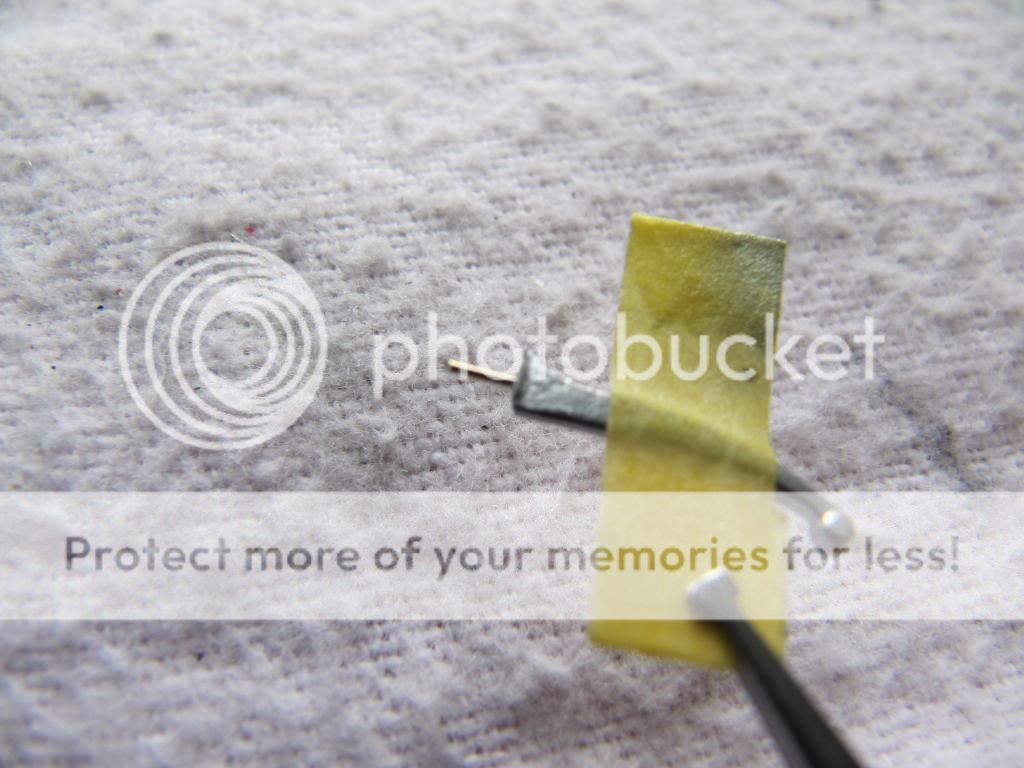

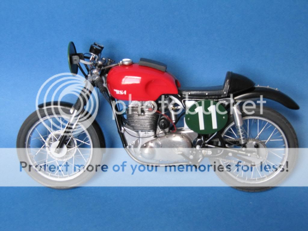

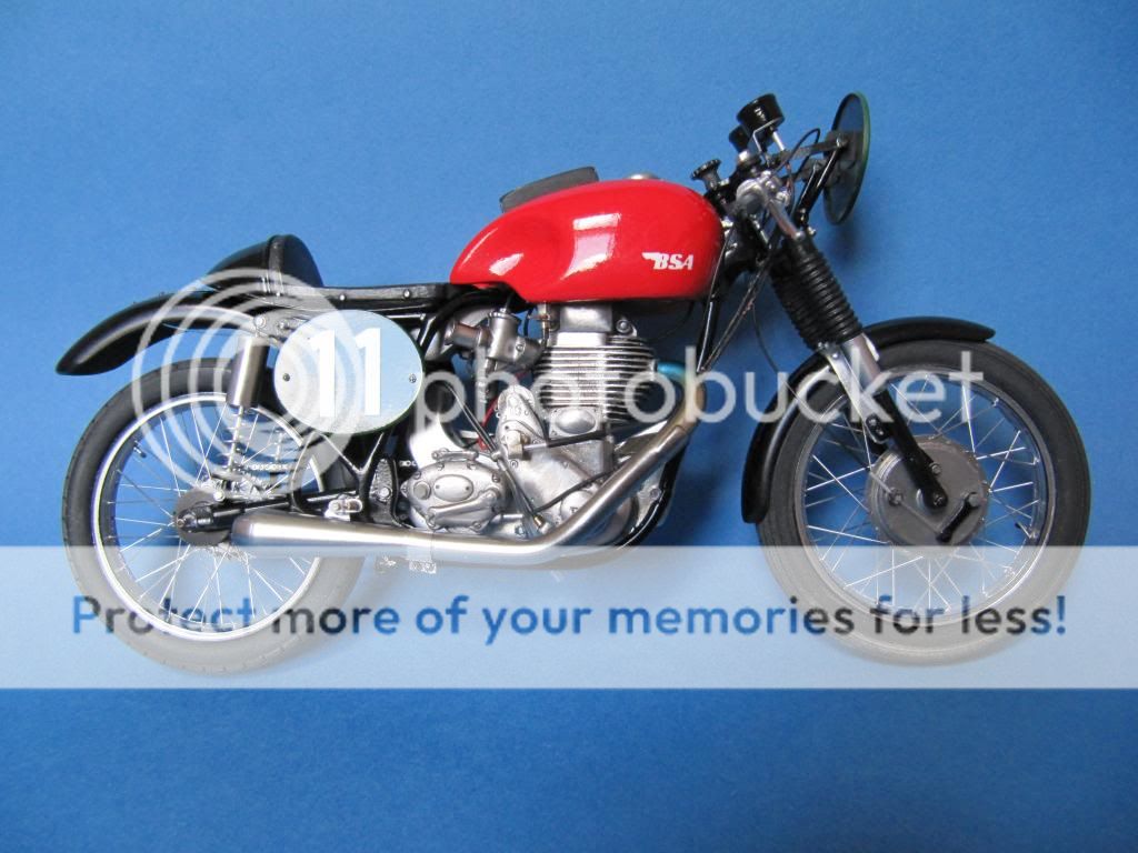

Postby Sparbucks » Fri Apr 18, 2014 11:58 am
APART FROM TRYING TO WORK OUT HOW TO DESIGN A STURDY STAND (FOR THE WEIGHT) - THE BIKE IS FINISHED!

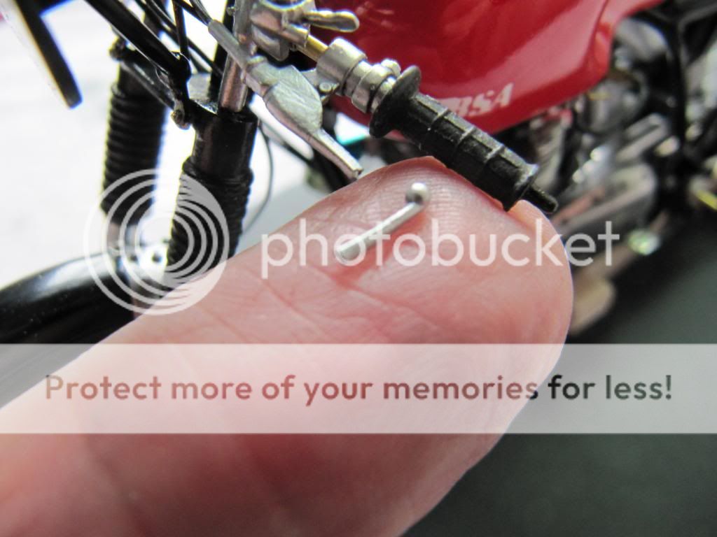

But to give it it's due, the bike didn't give up without a fight. On the very last day, an errant finger movement broke the clutch lever on the handlebars. A frantic search of the spares box found one attached to a twist-grip and this was snipped off, trimmed to length, drilled and pinned. The broken piece still attached to the bars was also trimmed and drilled. C/A did the rest! It was definitely sweaty shirt-tail time.

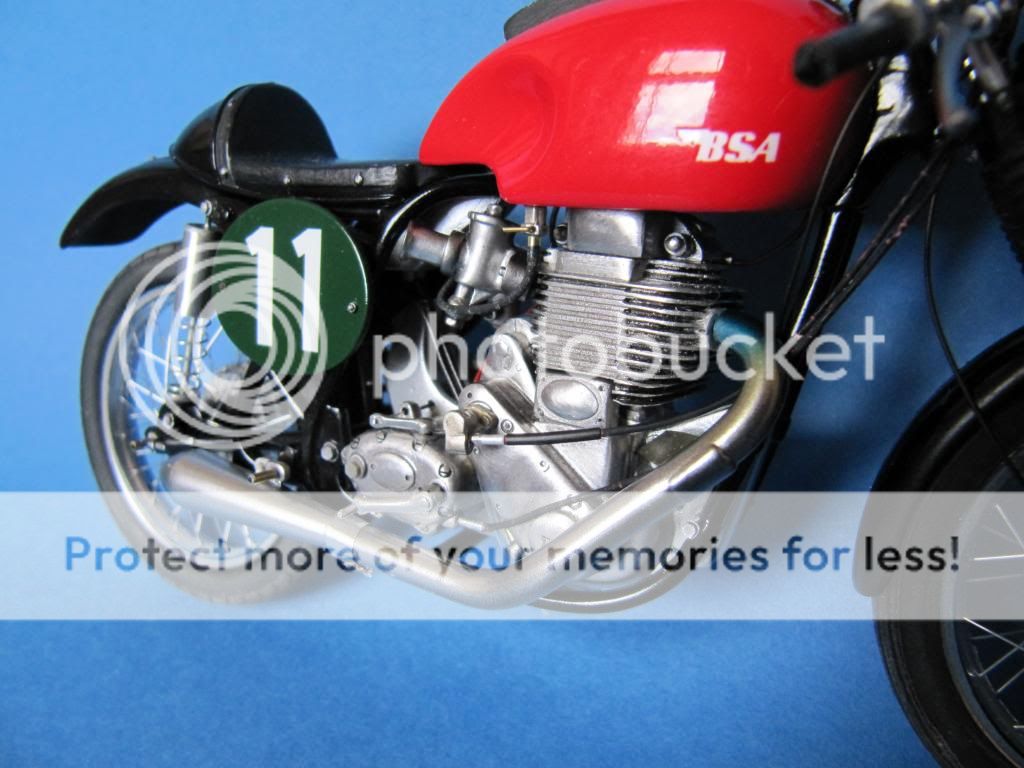

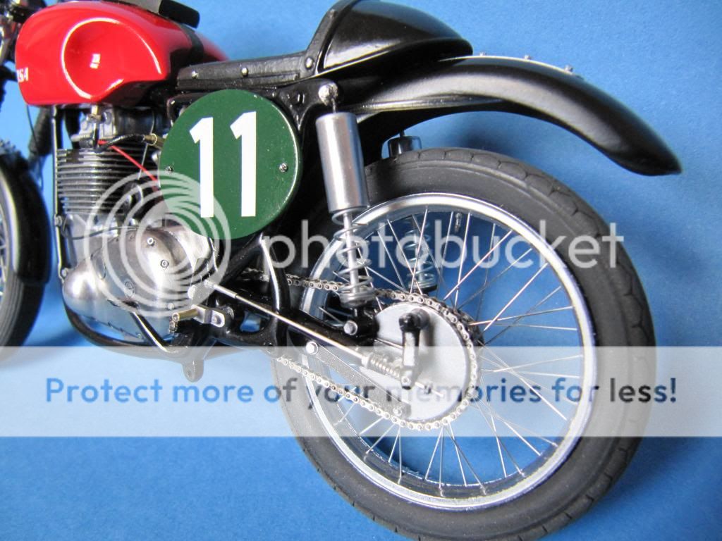

The exhaust system was fitted after modifying the right hand footrest attachment (during test fittings) which also became the attachment for the modified megaphone silencer. The exhaust pipe was given fine coats of Alclad Transparent Blue and Yellow at the business end after the whole assembly had been sprayed with Zero Gloss Black and then Chrome. Oh, and not forgetting the 'chin' pad on the tank.
Final attachments were petrol pipes (3), the transparent breather pipe from the central oil tank exiting adjacent to the left suspension unit top and then the racing numbers.
So, that's it! One BSA DBD34 converted from road going to a racing 'clubman' track machine. It was almost binned on three occasions, but I am glad I persevered with the project. Would I attempt another from the white metal/plastic Mr Hobby stable? No! However, having said that, their method of spoking the wheels was excellent and very simple - far ahead of the Tamiya system in my view.
