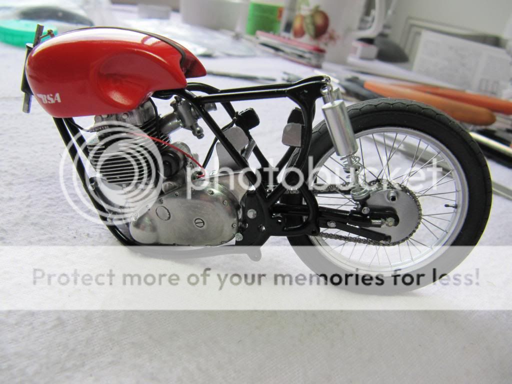

The assembly starts here. For gluing the primary chain case, the timing case and the gear box, I used Evo Stick 5 minute Epoxy sparingly. The piece of wire you can see protruding from the gear box was used to help alignment of the cable hole in the gearbox/engine plate and the gearbox's clutch operating lever.
The clip on handlebars have been C/A'd into position and the front end can now be assembled. Four small resin 'fixing' bolts were C/A'd to the inside of the handlebars where they attach to the forks. At the present time the exhaust/silencer assembly is being dry fitted to ascertain the location of the silencer's P/E fixing plate.

The wiring and pipework has started and I am using a mix of kit wire and some of the Preston Innovations fishing rubber line I used on my recently completed 'Dragonfly'. It is very soft and pliable giving a natural bend where required. It has to be painted black for my purposes but I have shown a before after pic to illustrate this.

Like the conversion, the assembly is taking (or seems to be) an equally long time. It doesn't help when I decided to change the part of the kit's headlamp support/fixing stays. They were going to be part of the racing number plate fixings but looked a little too fat for my liking, so I made a couple of replacements from a piece of sheet brass. I decided to keep the original white metal 'horseshoe' shaped fixing. A quick primer and a coat of black and they were ready in less than half an hour. The racing number plate and it's attachments were assembled using resin bolts.
I made a 'rubber' tank strap from two layers of latex masking film which were some unused off-cuts from my friend Mal Mayfield's Miracle Masks from a previous build. The strips were sprayed with Tamiya Rubber Black and then stuck onto the tank. In the meantime, the Amal TT Carburetter has been epoxied to the engine cylinder.

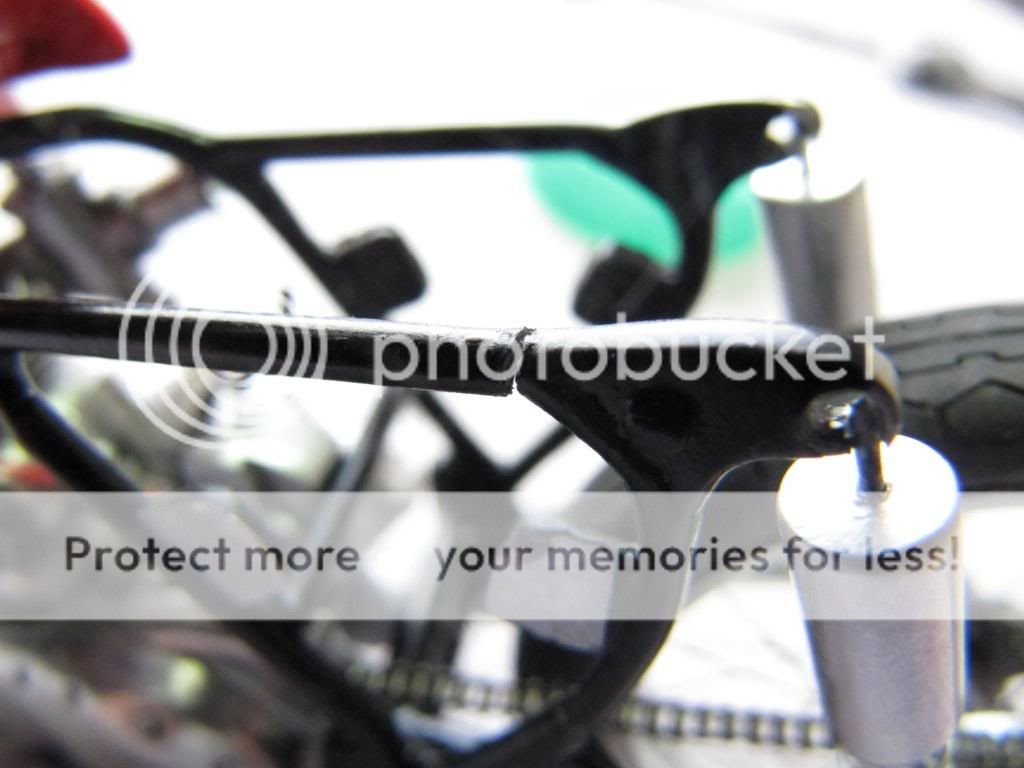

Back to the work bench after a short break and have spent some time preparing the swinging arm/suspension units and rear wheel assembly.

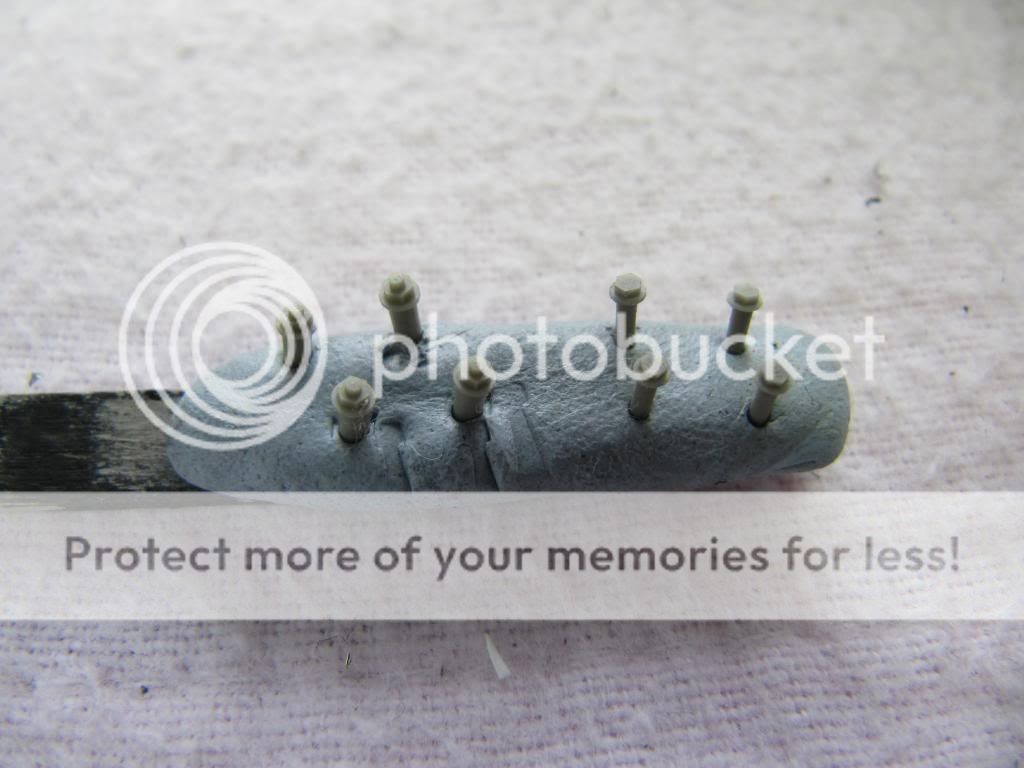

Much of the time has been taken up by fitting resin nuts and bolts to (strangely) the rear wheel, swinging arm and suspension units plus the rear brake security linkage. These had to be sprayed with primer and then Alclad White Aluminium.
However, as experienced by number1, I had a small disaster which was quite quickly rectified. While trying to 'adjust' the white metal sub-frame, the left hand rear top tube parted company with the suspension unit top fixing lug. This has been pushed back into position and super-glued but will need some very fine filler, a quick rub down and then respray :angry-banghead: However, it will also be an opportunity to respray the top suspension/frame lugs where the black paint has chipped away! Always try to turn a negative to a positive!!
So things have taken two steps forward and one step back - hey ho! It's nice to be back!
